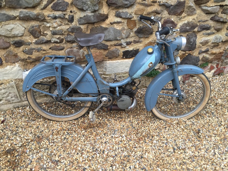

MessagePosté le: Sam 17 Oct - 11:17 (2015)    Sujet du message: Our BB1 1957 Répondre en citant
Thanks !
See our BB
We are building the list of parts of the chassis and later for the engine.
Capotage
V17321                 Capotage Guache
V17322B               Capotage Droite
V17323 E              Pare Chaine
Bequile
V17027                 Bequille central
V17031                 Resort de bequille
4178                       Glace a eperon en verre
4177                       Porte de phare chromee nue format visiere (we have one, but a bit damaged )
184A                      Cabochon rouge
Not sure this is still available:
Commande de Compteur
788A                      Commande de Compteur
Cable
1085 B                   Gaine guipee 3*5 (100+90+86+48 cm ???)
Niels and Tim

MessagePosté le: Sam 17 Oct - 11:23 (2015)    Sujet du message: Our BB1 1957 Répondre en citant
sorry here the BB
Niels and Tim
